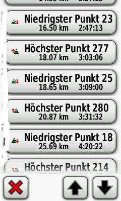

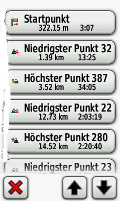

    Changes made from version 3.41 to 3.42:
    • Added date/time to Elevation Plot page when plot future is active.
    • Added display of icons to the lists in Where To? > Waypoints and the Geocaching application.
