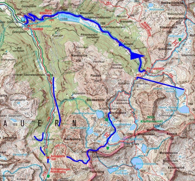

  • Do You have any experience with data "Slope next waypoint"?
    I tried several times, but I always unsucceed. I mean I chose navigation to the WPT and the field "Slope next waypoint" remained blank.
    What I did wrong or is it annoying BUG made by Compe?
    See picture:
    [Blockierte Grafik: http://www.garniak.pl/download/file.php?id=8904]
    BTW, "slope" fields shows only with GPS-FIX and ONLY when navigating the TRACK (does not work with Routes and WPTs :-().
  • BTW, in current beta 2.9rc2, only two datafields left: "Slope" and "Next slope".
    Slope to destination and Slope next waypoint were abandomed...
  • What I did wrong or is it annoying BUG made by Compe?
    Neither nor.
    Afaik it's only a state of development.
    And like with routes altitude profile, routes actually doesn't seems to have much priority for Compe.
    I don't miss it to much. And probably most users feel like this.;)
