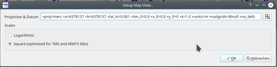

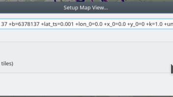

  • Well, this Square behaviour is so much better for tiled maps! Should I change datum from mine :
    +proj=merc +a=6378137.0000 +b=6356752.3142 +towgs84=0,0,0,0,0,0,0,0 +units=m +no_defs
    to yours:
    +proj=merc +a=6378137.0000 +b=6378137.0000 +lon_0=0.0 +x_0=0.0 +y_0=0 +k=1.0 +units=m +nadgrids= @Null +no_defs
    With square setting map looks very close as it should be, but not really as indented. It has sharp blurred areas - please, have a look https://a.radikal.ru/a14/2004/d5/07f06e64b384.png
